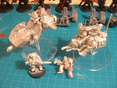

since i'll be fielding a pair of speeders in my EC collection, i wanted to try converting the current armoured-up version into something similar to the older models.
for those not aware, there was 2 other styles of speeders before the current one we're used to seeing. the first was this guy, a Rogue Trader Land Speeder:
then came this guy, which is what i decided to try and emulate; a 2nd Edition Land Speeder:
Here's another shot of the two unpainted:
So my goal was to make something smaller and less bulky, like the 2nd Ed. model, using the current Land Speeder model. Here's what i came up with for the first one:
The weapons are just sitting loose where they are to give a rough mock-up of their locations.
